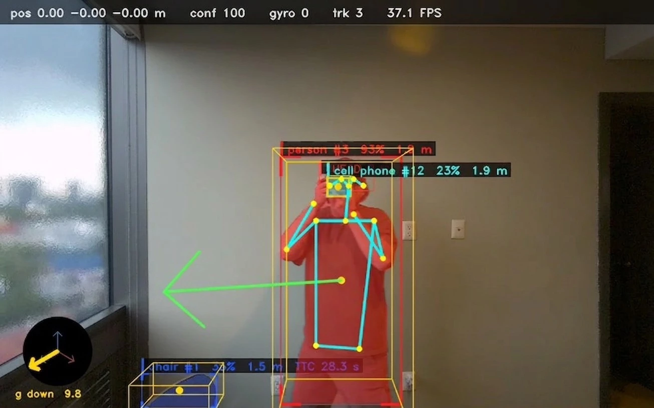

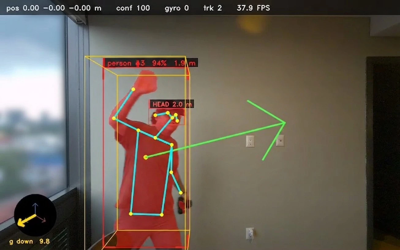

There you can see the sample application showing the stuff you can do with the metis running yolo8l and the zedx camera sdk. You can see the labels, distances, boxes, the arrow showing the calculated direction of the object and the 3D volumes for detected objects. All in real time.
