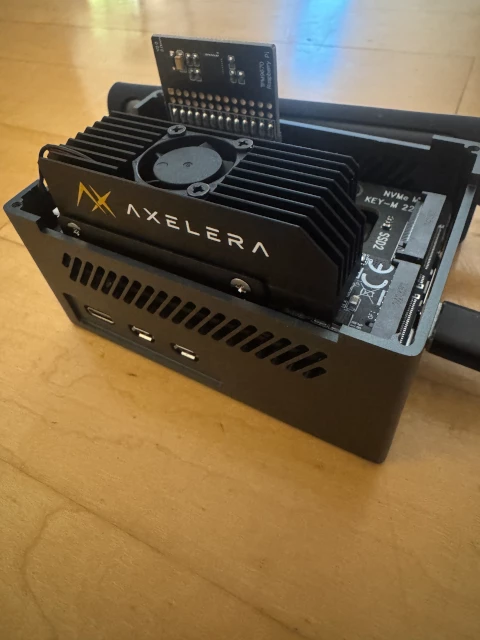

Just to double check, you mentioned you’ve tried the Geekworm X1004 HAT (which doesn’t look like it supports PCIe Gen3, which is an issue with Metis); what’s the other HAT you’ve been testing with?
Forum|alt.badge.img+1
  • Ensign
  • May 12, 2025
  • May 12, 2025
That’s a really nice piece of kit, actually! 😃 It does suggest that it’s PCIe Gen3 compatible, and I bet the power supply is more than adequate. Did you have it working in this case initially?
  • Ensign
  • May 12, 2025
Worked until i make Updates
