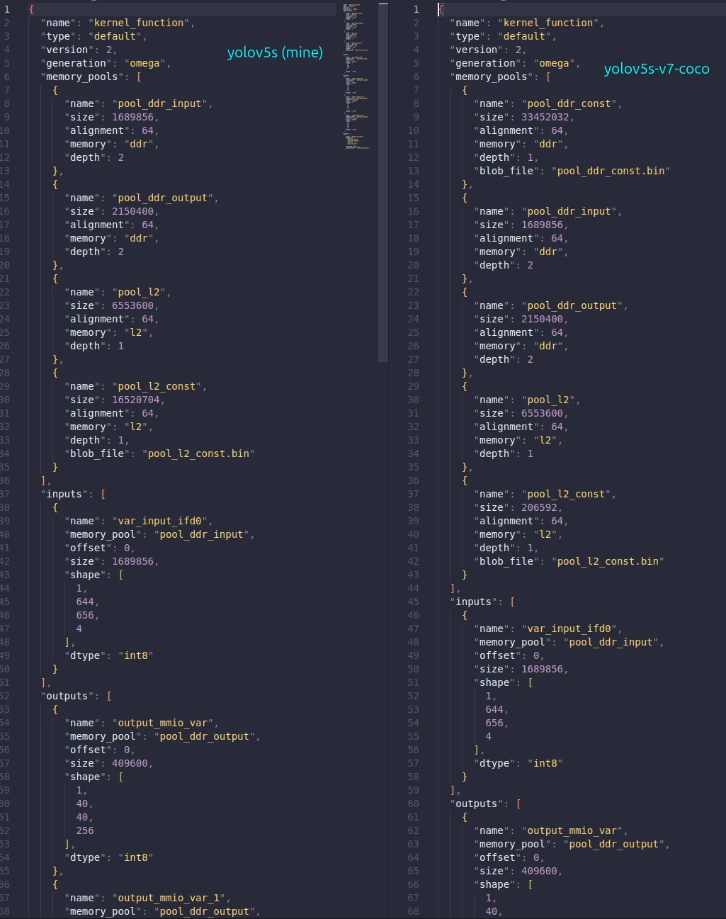

After further investigating, I find that the requested memory of 16520704 corresponds with the size of the pool_l2_const memory pool.
There seems to be something wrong with my model.json. This was created using the CLI compile command using a yolov5s.onnx model. When deploying a yolov5s-v7-coco the model.json is different and there is no error with memory allocation. Should I not use the compile command or is it something else?

Hi ​@Siegfried, thanks for the comparison table, that’s a great idea!
I think you’re right, that the issue comes down to the size of the pool_l2_const block in your custom-compiled yolov5s model. As I recall (and I’ll check this internally) each core has 2MB of SRAM, so looking at the comparison table the size of your custom model exceeds that, being around 16MB. Hence the allocation failure in AxRuntime, most likely.
By comparison, the zoo’s yolov5s-v7-coco version has a pool_l2_const size closer to 200KB.
What about trying compiling and deploying your model using the deploy.py tool instead of compile?
