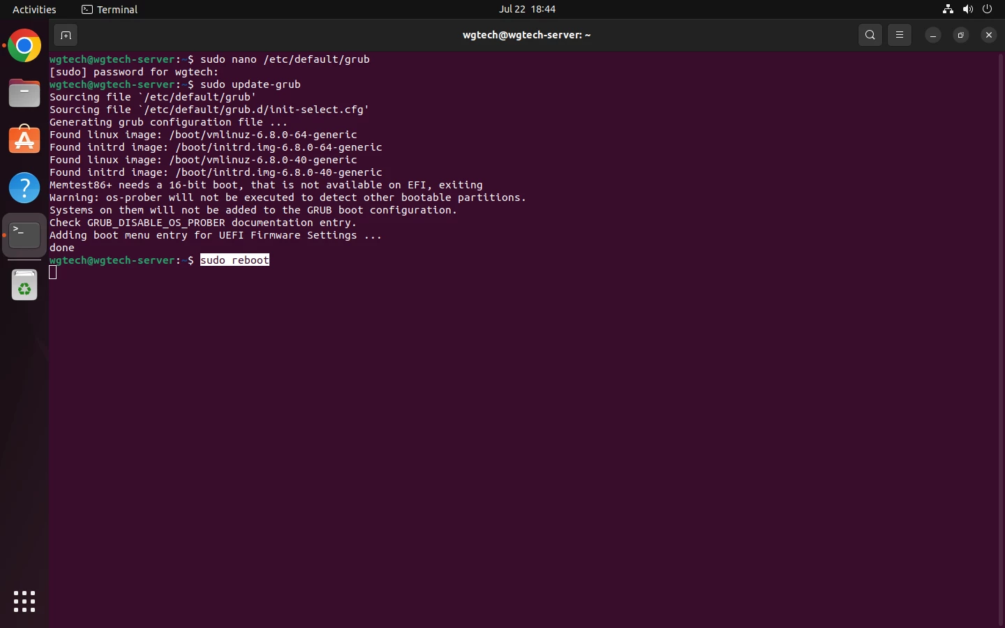

Hi ​@WGPravin ,
What we see in the very last error you shared is that there is not communication Host ↔ Metis PCIe card.
Let’s try the following:
Disable IOMMU
In some kernels, the intel_iommu=off kernel parameter should be added at boot.
For example, in Ubuntu, the grub file needs to be modified:
sudo nano /etc/default/grub
where you need to disable IOMMU by adding intel_iommu=off  parameter:
GRUB_CMDLINE_LINUX_DEFAULT="quiet splash intel_iommu=off"
Save the file, then run:
sudo update-grub
and to apply the changes:
sudo reboot
Please follow all these steps and let us know if it worked. Looking forward to your reply.
Also, can you check is Secure boot is disabled?
Note that here you can find this and other troubleshooting advice: https://support.axelera.ai/hc/en-us/articles/26261515755538-PCIe-Troubleshooting-Guide
Best,
Victor

Hi ​@Victor Labian and ​@Spanner  now I tried victors update now the device is not getting recognized.
Now the device is not getting recognized after boot what should i do?
Error I am getting after adding the Command in Grub:
(venv) wgtech@wgtech-server:~/axelera/voyager-sdk$ sudo nano /etc/default/grub
(venv) wgtech@wgtech-server:~/axelera/voyager-sdk$ axdevice --refresh
ERROR: No target device found in lspci output
ERROR: AXR_ERROR_CONNECTION_ERROR: No target device found in lspci output
(venv) wgtech@wgtech-server:~/axelera/voyager-sdk$ lsmod | grep metis

Hi ​@Spanner ​@Victor Labian  i tried your your request now it is like this
# If you change this file, run 'update-grub' afterwards to update
# /boot/grub/grub.cfg.
# For full documentation of the options in this file, see:
# info -f grub -n 'Simple configuration'
GRUB_DEFAULT=0
GRUB_TIMEOUT_STYLE=hidden
GRUB_TIMEOUT=0
GRUB_DISTRIBUTOR=`lsb_release -i -s 2> /dev/null || echo Debian`
GRUB_CMDLINE_LINUX_DEFAULT="quiet splash intel_iommu=off pcie_aspm=off"
GRUB_CMDLINE_LINUX=""

wgtech@wgtech-server:~$ echo 1 | sudo tee /sys/bus/pci/rescan > /dev/null
wgtech@wgtech-server:~$ lspci -tv
-[0000:00]-+-00.0 Intel Corporation 12th Gen Core Processor Host Bridge/DRAM Registers
+-01.0-[01]----00.0 Synopsys, Inc. DWC_usb3 / PCIe bridge
+-02.0 Intel Corporation AlderLake-S GT1
+-06.0-[02]----00.0 Sandisk Corp WD SN560/SN740/SN770/SN5000 NVMe SSD
+-0a.0 Intel Corporation Platform Monitoring Technology
+-0e.0 Intel Corporation Volume Management Device NVMe RAID Controller
+-14.0 Intel Corporation Raptor Lake USB 3.2 Gen 2x2 (20 Gb/s) XHCI Host Controller
+-14.2 Intel Corporation Raptor Lake-S PCH Shared SRAM
+-14.3 Intel Corporation Raptor Lake-S PCH CNVi WiFi
+-15.0 Intel Corporation Raptor Lake Serial IO I2C Host Controller #0
+-15.1 Intel Corporation Raptor Lake Serial IO I2C Host Controller #1
+-15.2 Intel Corporation Raptor Lake Serial IO I2C Host Controller #2
+-16.0 Intel Corporation Raptor Lake CSME HECI #1
+-17.0 Intel Corporation Raptor Lake SATA AHCI Controller
+-1a.0-[03]--
+-1b.0-[04]--
+-1c.0-[05]--
+-1c.2-[06]----00.0 Intel Corporation Ethernet Controller I226-V
+-1d.0-[07]--
+-1f.0 Intel Corporation Raptor Lake LPC/eSPI Controller
+-1f.3 Intel Corporation Raptor Lake High Definition Audio Controller
+-1f.4 Intel Corporation Raptor Lake-S PCH SMBus Controller
\-1f.5 Intel Corporation Raptor Lake SPI (flash) Controller
  • Ensign
  • July 22, 2025
Finally after multiple cycles i was able to get it to recognize the device
+-01.0-[01]----00.0 Axelera AI Metis AIPU (rev 02)
+-1a.0-[03]--
+-1b.0-[04]--
+-1c.0-[05]--
+-1d.0-[07]--
