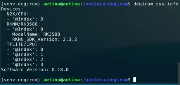

Hi ​@shashi.chilappagari I updated to the latest degirum version using pip’s upgrade method, and then also updated the Axelera driver (both following the instructions on the Degirum. However, somehow the Metis card is not getting detected by degirum sys-info
I did hard-power cycle (totally removing power) the board as mentioned in the degirum docs, even several times, but no luck. I also refreshed the Axelera device and could see it from the voyager-sdk
How do I go about troubleshooting this? To recap, I am using the Aetina RK3588 with Metis M.2.
shashi.chilappagari
Ensign
Hi ​@saadtiwana
I reported this internally and our engineer responsible for Axelera integration will help you.
