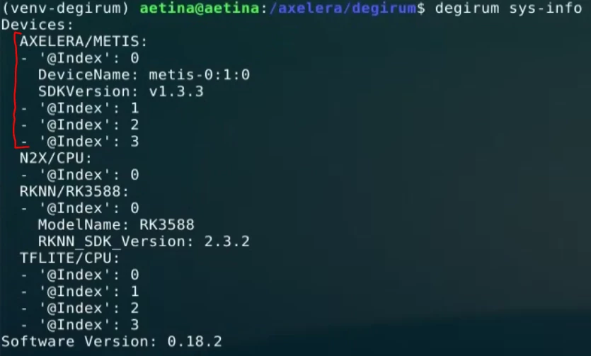

Btw, one thing I wanted to ask: When we have a device with multiple cores (I believe those are seen as @Index<n> in the sys-info ouput), can we control which core(s) or how many cores to run a model on? I’m thinking of cases when one needs to run multiple models in parallel using degirum.
Once again, thanks a lot for expediting the release for the arm architecture..I am humbled!
shashi.chilappagari
Ensign
Hi ​@saadtiwana
Very happy to hear that PySDK is working on your side. Our heartfelt thanks to you for sticking with us and trying it for 3 times. Your feedback alone improved our PySDK a lot (support for new runtime version, support for ARM).
Yes, we can control the number of cores to run a model on but not the exact cores on which they run. But once assigned, the cores for the model remain fixed. After loading a model, you can see `model.devices_available` to see all devices on which you can run (it should show [0,1,2,3]). You can then assign a list of devices to `model.devices_selected` to specify the cores on which you want to run the model. We will publish a detailed user guide on this but feel free to reach out in the meantime if you encounter any issues with this or any other feature.
