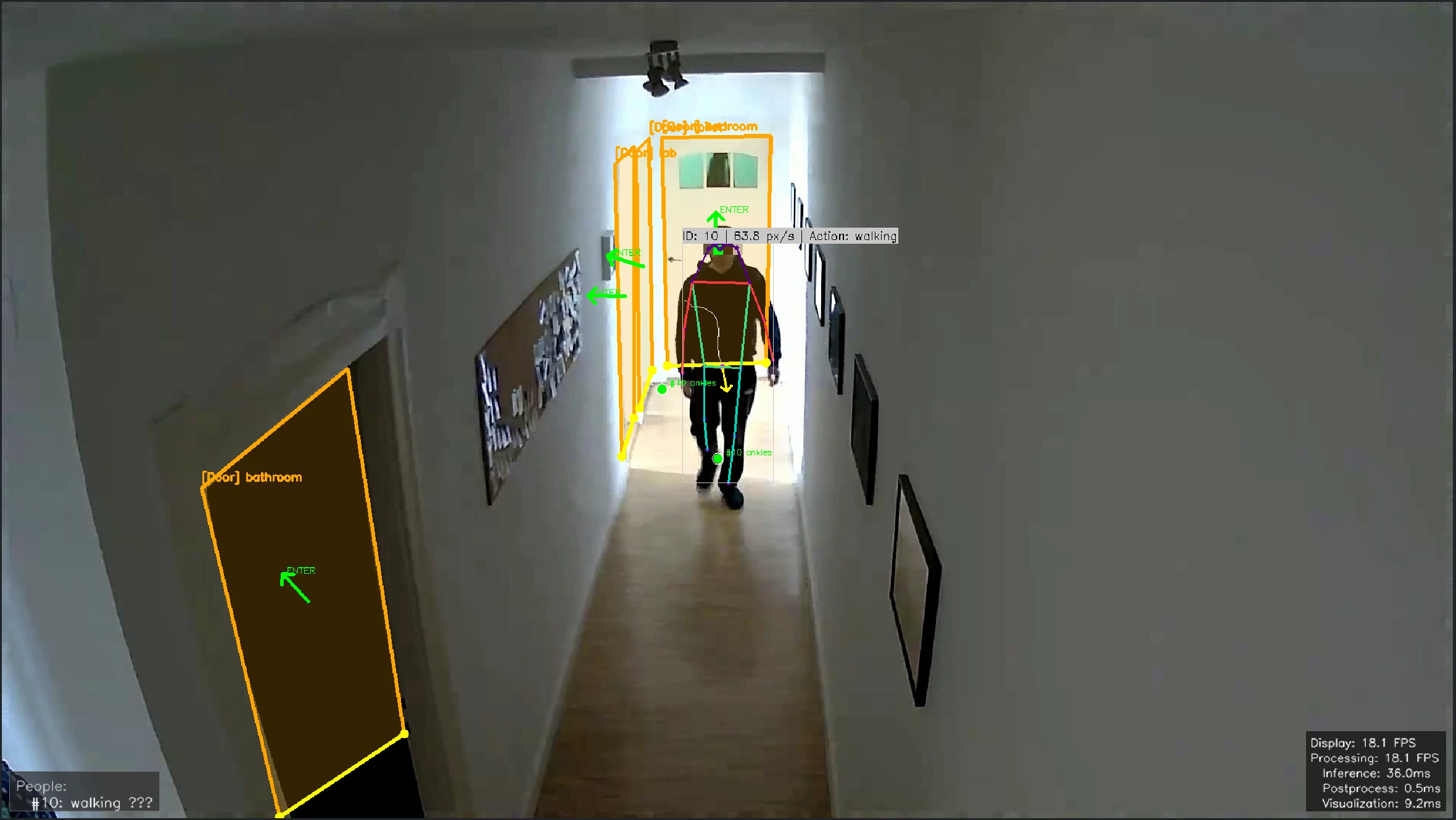

PoC - Debug Visualization

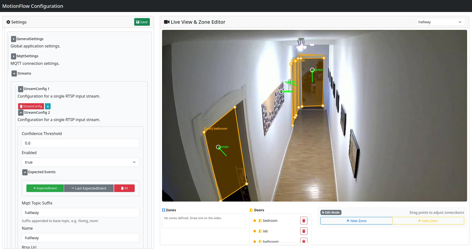

Complementing this is a separate Web UI, which serves purely as a visual editor for the configuration file.
Zones & Doors
Zones are just polygons you define e.g, "Couch", "Desk", etc. The system checks if tracked persons are inside.
Doors are a special case of a zone, they also have a "enter direction" vector. Here, I'm using a tripwire approach: when someone's ankles cross the door line, it fires an enter/exit event.
The tricky part is side angles where people vanish behind walls mid-crossing. To handle this, the system tracks velocity: if a person disappears near a door while moving toward it, it counts as a crossing. Seems quite robust!
Config Web UI
I thought I'd need a web interface for configuration eventually, but figured it makes life much easier to have it up-front. Especially with editing polygon coordinates in the yaml file..
Since I'm not a web dev, I let Copilot do most of the scaffold and came up with a Flask UI quickly.
Web UI
