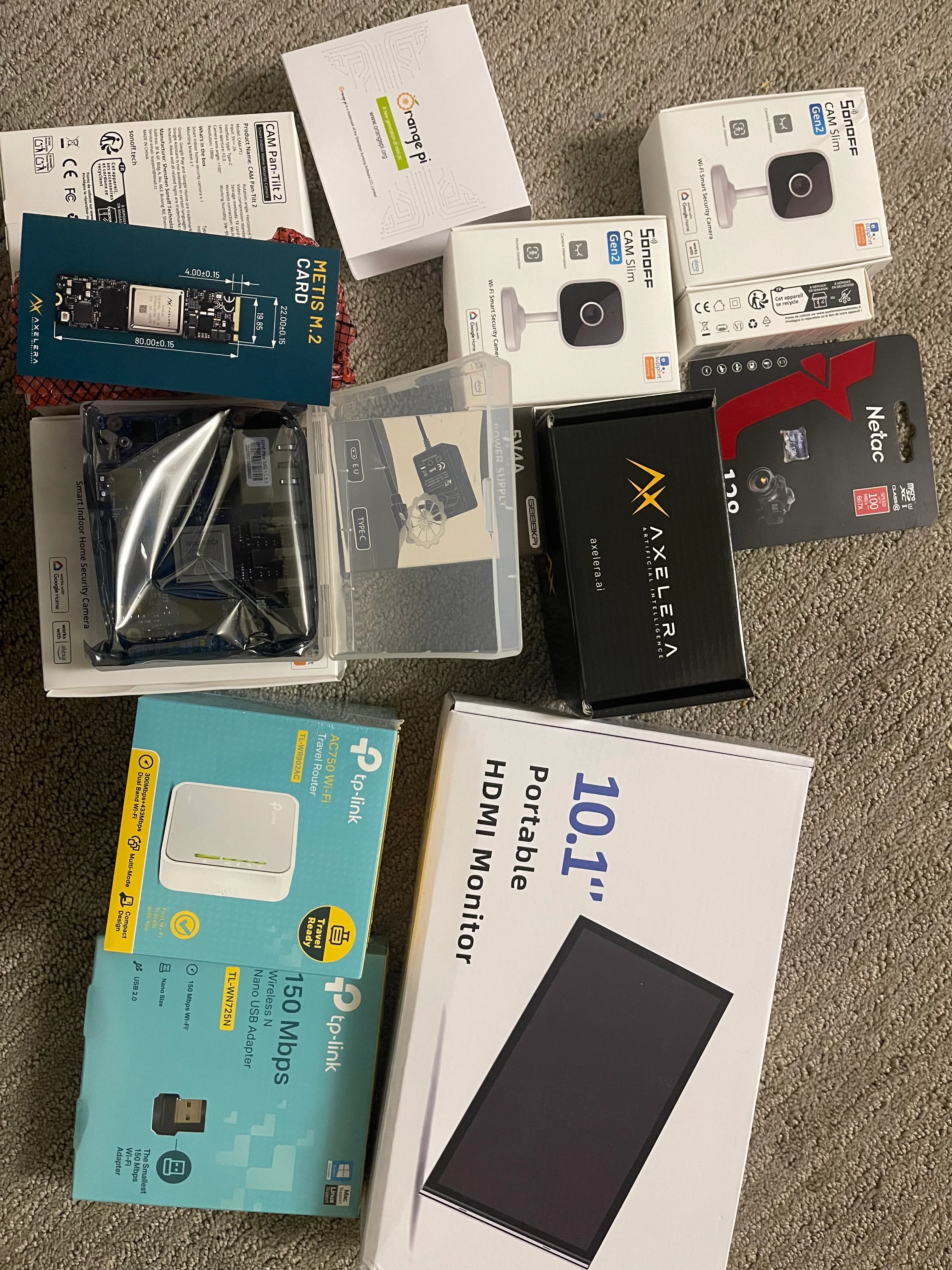

Update:
i just got the kit on new year eve.  So excited and now the fun begins.

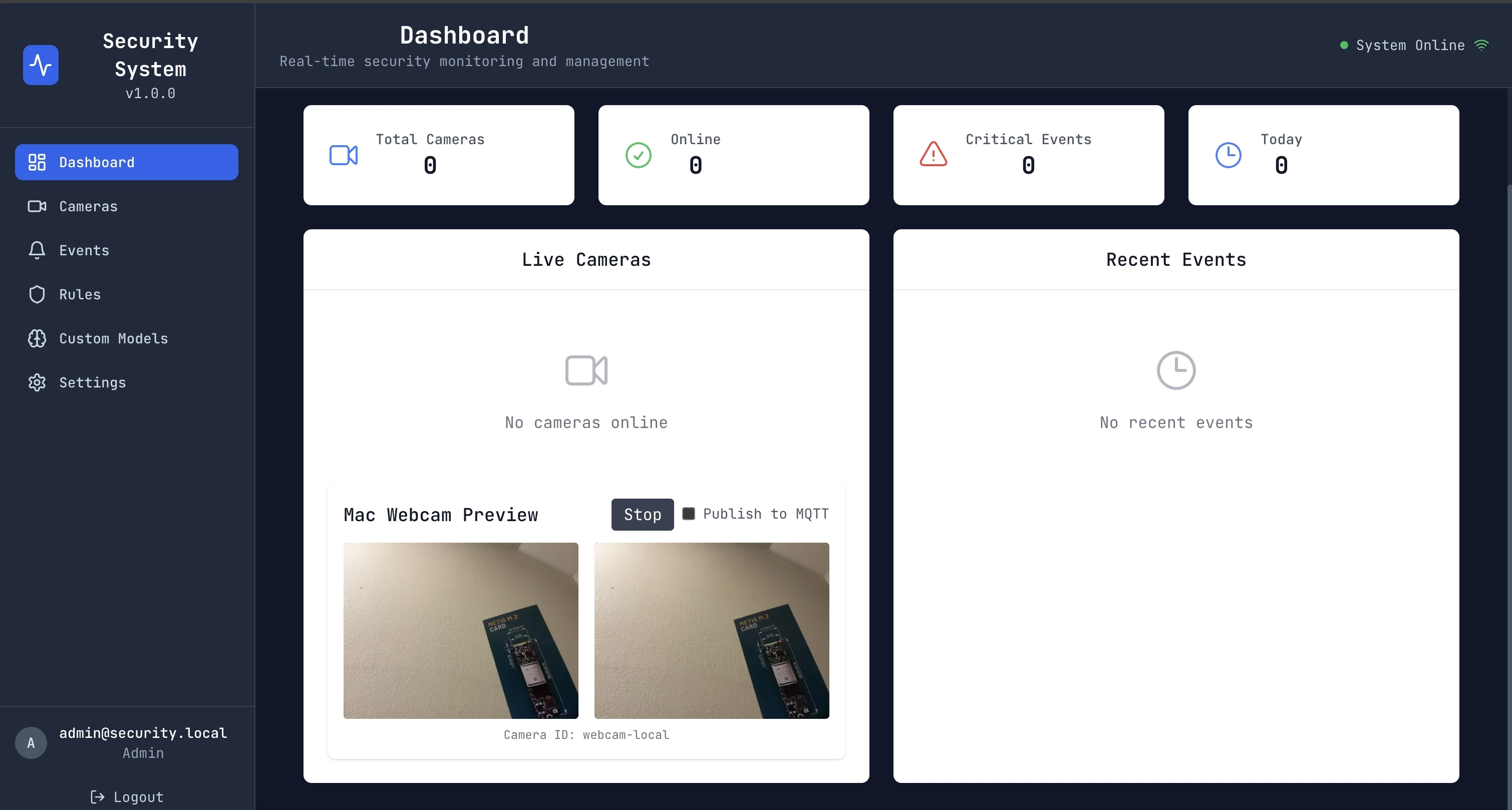

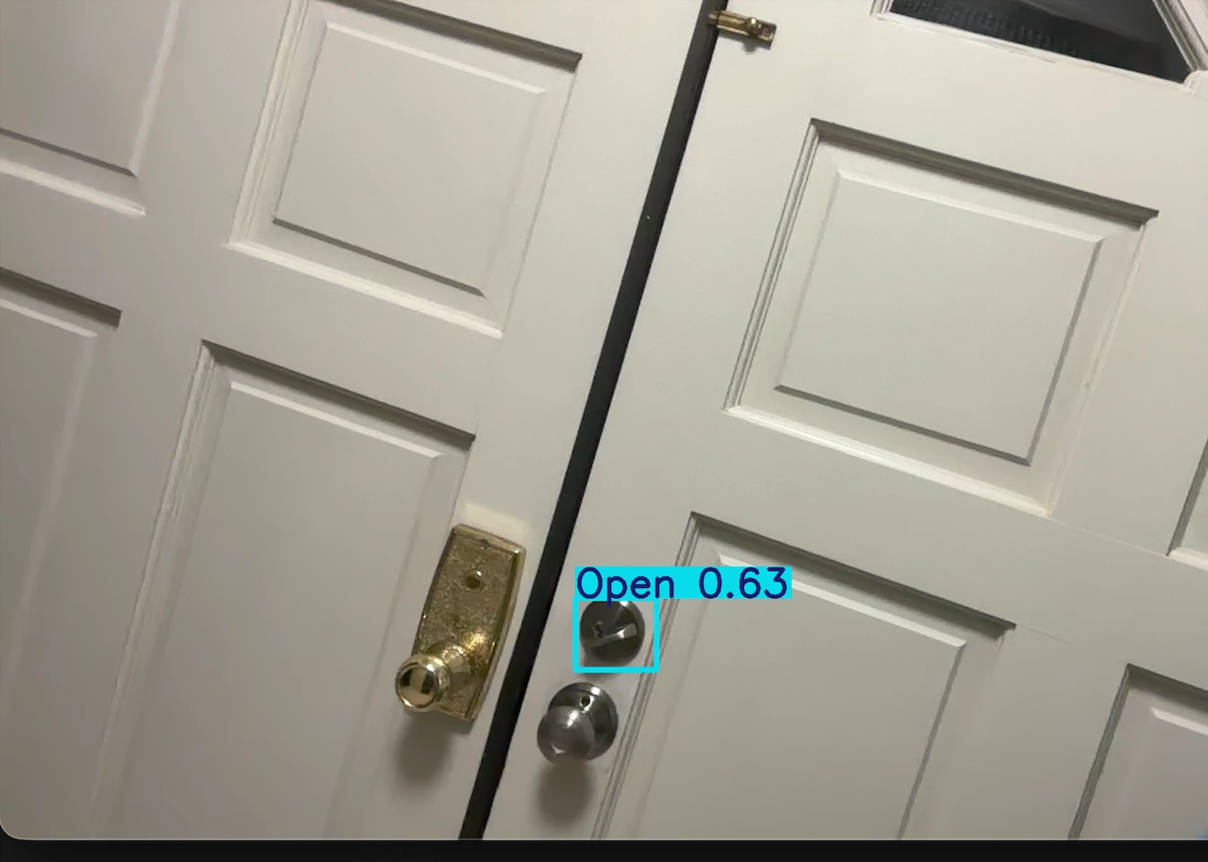

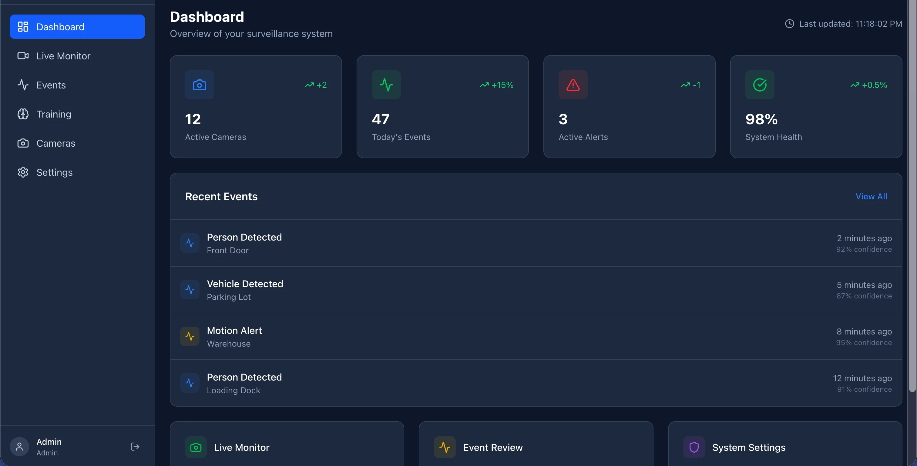

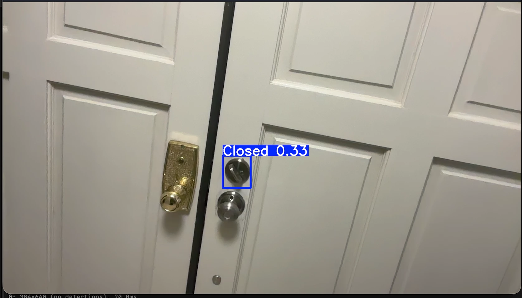

Update:
I was able to run custom trained Yolo11 to identify door latch position successfully. Kudos to the developer of inference.py amazing tool to work with .
Current status.
Hardware side:
1. Was able to run custom trained Yolo model
2. i am able to get the good detection for 1 video stream
Software:
the app is getting refined. Got basic stucture in place and i am able to see the events and configure cams and get various events
Next to do:
hardware:
I am researching on how to run Yolo11 efficiently to incorporate 4 cams, 60fps*4 would be ideal. but i might have to drop the frame rate to support multiple cams.
Pi is CPU getting really hot at times( may be due to the app, i might have to add fan to the setup . but the Metis card is rock solid . i am amazed .
Sotware:
1. working on a way to create labels through app on custom images, so that it can be added to custom model from the app.
2.tagging the events to make sure the model understand the situation, e.x door is open coz some one is picking package or kids playing out.
3. refining the streaming of the videos which is taking a toll on the Pi.​​​​​​​
​​​​​​​Regards,

  • January 19, 2026
Awesome work! I think I mentioned before how my local group of tinkerers have been trying to figure out a way to add a sensor to detect if a door is locked (not just closed, not just with the deadbolts in place, but a locked cylinder) with no success. You’re closer than we’ve ever managed already!
