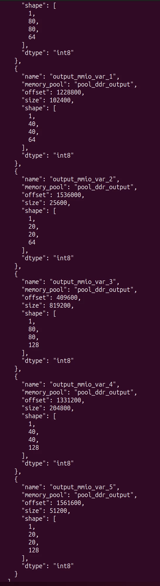

I know that each model has its own folder inside the build/ with important information such as “input_shape”, “output_shape”, “dequantize_params”, “output_dtypes”, etc.
I have these tensors as output and I'm having trouble interpreting them:
First:
[TensorInfo(shape=(1, 80, 80, 64), dtype=<class “numpy.int8”>, name=“output_mmio_var”, padding=[(0, 0), (0, 0), (0, 0), (0, 0)], scale=0.08608702570199966, zero_point=-65), TensorInfo(shape=(1, 40, 40, 64), dtype=<class 'numpy. int8'>, name=“output_mmio_var_1”, padding=[(0, 0), (0, 0), (0, 0), (0, 0)], scale=0.07383394986391068, zero_point=-54), TensorInfo(shape=(1, 20, 20, 64), dtype=<class 'numpy. int8'>, name=“output_mmio_var_2”, padding=[(0, 0), (0, 0), (0, 0), (0, 0)], scale=0.07019813358783722, zero_point=-43)]
Second:
[TensorInfo(shape=(1, 80, 80, 128), dtype=<class 'numpy.int8'>, name='output_mmio_var_3', padding=[(0, 0), (0, 0), (0, 0), (0, 48)], scale=0.10051003098487854, zero_point=141), TensorInfo(shape=(1, 40, 40, 128), dtype=<class 'numpy.int8'>, name='output_mmio_var_4', padding=[(0, 0), (0, 0), (0, 0), (0, 48)], scale=0.1407421976327896, zero_point=119), TensorInfo(shape=(1, 20, 20, 128), dtype=<class 'numpy.int8'>, name='output_mmio_var_5', padding=[(0, 0), (0, 0), (0, 0), (0, 48)], scale=0.16894204914569855, zero_point=112)]
I know that 20/40/80 are different feature map resolutions.
In the second tensor, since the padding is [(0, 0), (0, 0), (0, 0), (0, 48)] → 128 - 48 = 80 so i’ts supposed to ignore the last 48 values and deal with the 80?
if possible i could use some help interpreting what the tensors mean? If they are the bounding boxes, scores, class….
Thank you 😊

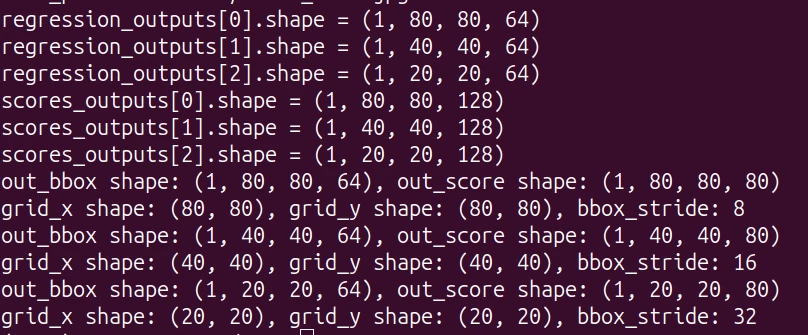

I'm developing the script in python (script.txt), it has commented lines because it's not working but you can already see the shape of the tensors received (output_tensors.png).
My problem is interpreting these tensors in order to get a bounding box result and a score with some detection. It seems that it's not yet in the final format common in yolo (1,84,8400) but in some previous stage. However, this is what we get from the yolov8n-coco model you provided,  since it is consistent with the yaml files (output_tensorsyaml.png).

The compiler also generates the “postprocess_graph.onnx” which is required to get the final output in the yolo format, i.e. (1,84,8400). You can find this graph in the path “yolov8n-coco-onnx/yolov8n-coco-onnx/1”.
And the outputs you get from the “Worker” instance require depadding, then dezeroing, and scaling; for this, please see [1]. Once we have the outputs in fp32 format, we can feed them to the “postprocess_graph.onnx” [^] and get the final yolo output.
