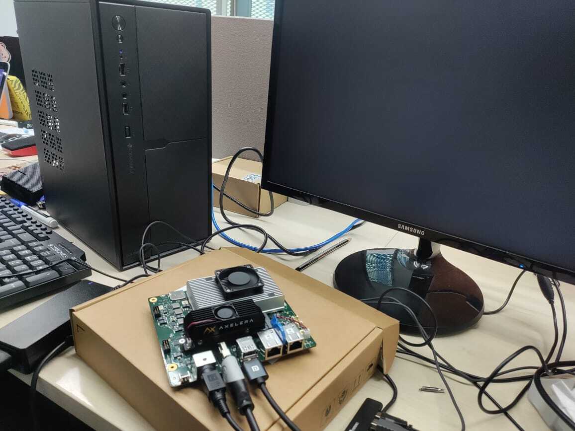

i am using Metis M.2 Eval System with Aetina RK3588 Industrial Motherboard . i connected everything to it keyboard, monitor and mouse and power supply . the monitor is showing blank screen . but yesterday it is working . why it is not working now . is there any solution.

Hmm, that’s an odd one. So it was all up and running and working well initially, is that right?
I guess before we dig too deep into the technicalities, we could rule out a few simpler matters just to make sure it’s not something more basic. Could you check and confirm things like:
  • It’s powering up - the host system, the monitor, etc. Flashing lights on the board, fans running, standby light on the monitor, and such. Just to confirm that everything’s got power.
  • That the HDMI cable is properly connected at both ends. And if so, do you have a second cable you could try, just to test it? Alternative, if you don’t have a spare, could you try the HDMI cable on something else like the TV? Just to confirm it hasn’t got a bad connector in the plug or something.
  • The Metis M.2 is seated properly on the motherboard, and all the connectors feel good.
Let’s check the obvious first, and then dig deeper 😃 Thanks ​@saravanan

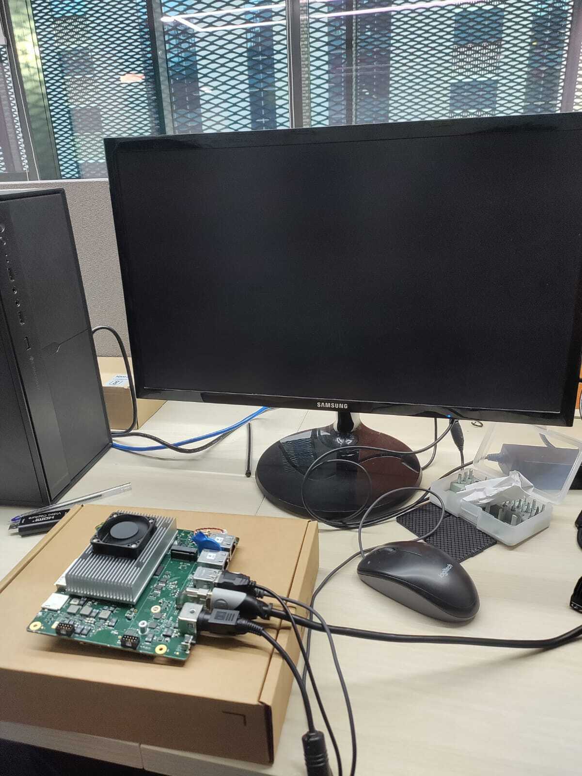

  • April 15, 2025
i removed the m.2 metis and tried it out but still same result.

Hi again ​@saravanan.
Okay, it’s sounding like the Aetina host system may need reimaging. Which has its own intricasies, but is quite do-able depending on capabilities and availability of a few components. Here’s the guide:
https://support.axelera.ai/hc/en-us/articles/25556440050194-System-Imaging-Guide-Aetina-RK3588
Please take a look at that, and let me know if you feel like it’s something you feel able to tackle. I can escalate this thread into a support ticket if so, and we can go from there with the engineering team helping you out 👍

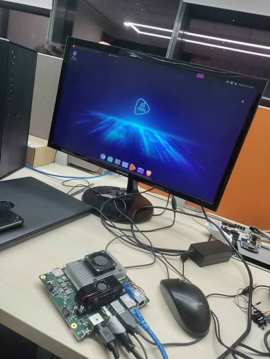

Hi, its working . Reimaged it . So do you have any docker image for voyager sdk ??

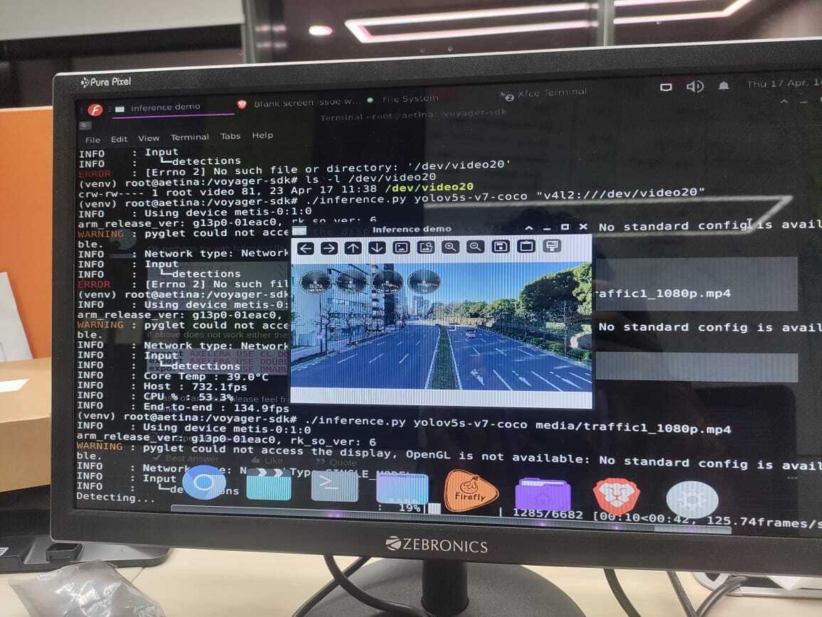

Hi again i reintalled the voyager-sdk in docker maybe last time it didn’t install some things . so now it is working with video input.
(venv) root@aetina:/voyager-sdk# ./inference.py yolov5s-v7-coco media/traffic1_1080p.mp4
INFO    : Using device metis-0:1:0
arm_release_ver: g13p0-01eac0, rk_so_ver: 6
WARNING : pyglet could not access the display, OpenGL is not available: No standard config is available.
INFO    : Network type: NetworkType.SINGLE_MODEL
INFO    : Input
INFO    :   └─detections
INFO    : Core Temp : 39.0°C
INFO    : Host : 728.8fps
INFO    : CPU % : 54.3%
INFO    : End-to-end : 140.0fps

TRACE   :axelera.app.transforms:   LetterboxToTensorAndNormalise(height=640, width=640, mean=[0.0], std=[1.0], datatype='float32', scaleup=True)
DEBUG   :yolo: Model Type: YoloFamily.YOLOv5 (YOLOv5 pattern:
DEBUG   :yolo: - 3 output tensors (anchor-based)
DEBUG   :yolo: - Each output has 255 channels
DEBUG   :yolo:   = 3 anchors × (4 box + 1 obj + 80 classes)
DEBUG   :yolo:   = 3 × (4 + 1 + 80) = 255
DEBUG   :yolo: - Shapes: [[1, 40, 40, 255], [1, 20, 20, 255], [1, 80, 80, 255]])
TRACE   :axelera.app.pipe.manager: Parse input and output options
DEBUG   :axelera.app.pipe.io: FPS of /home/firefly/.cache/axelera/media/traffic1_1080p.mp4: 60
DEBUG   :axelera.app.operators.inference: Enabled 4x1 inference queues for yolov5s-v7-coco because model_cores=1 and num_cores=4
DEBUG   :axelera.app.operators.inference: Using inferencenet name=inference-task0 model=/home/firefly/v1.2.5/voyager-sdk/build/yolov5s-v7-coco/yolov5s-v7-coco/1/model.json devices=metis-0:1:0 double_buffer=False dmabuf_inputs=False dmabuf_outputs=False num_children=4
DEBUG   :axelera.app.pipe.gst: GST representation written to build/yolov5s-v7-coco/logs/gst_pipeline.yaml
TRACE   :axelera.app.pipe.gst: environment at gst pipeline construction:
TRACE   :axelera.app.pipe.gst: {'AXELERA_DEVICE_DIR': '/opt/axelera/device-1.2.5-1/omega',
TRACE   :axelera.app.pipe.gst:  'AXELERA_EXAMPLES_DIR': '/opt/axelera/compiler-examples-1.2.5-1',
TRACE   :axelera.app.pipe.gst:  'AXELERA_FRAMEWORK': '/home/firefly/v1.2.5/voyager-sdk',
TRACE   :axelera.app.pipe.gst:  'AXELERA_RISCV_TOOLCHAIN_DIR': '/opt/axelera/riscv-gnu-newlib-toolchain-409b951ba662-7',
TRACE   :axelera.app.pipe.gst:  'AXELERA_RUNTIME_DIR': '/opt/axelera/runtime-1.2.5-1',
TRACE   :axelera.app.pipe.gst:  'AXELERA_USE_CL_DOUBLE_BUFFER': '0',
TRACE   :axelera.app.pipe.gst:  'AXELERA_USE_DMABUF': '0',
TRACE   :axelera.app.pipe.gst:  'AXELERA_USE_DOUBLE_BUFFER': '0',
TRACE   :axelera.app.pipe.gst:  'AXE_LZ_PERF_LOG_PATH': '/tmp/tmpyqlpch2o',
TRACE   :axelera.app.pipe.gst:  'AXE_PROFILING_CONFIG': 'HOST_TEMPLATE'}
TRACE   :axelera.app.pipe.gst_helper: Setting property filesrc0.location=/home/firefly/.cache/axelera/media/traffic1_1080p.mp4
TRACE   :axelera.app.pipe.gst_helper: Creating filesrc0 from filesrc
TRACE   :axelera.app.pipe.gst_helper: Setting property queue_in0.force-sw-decoders=True
TRACE   :axelera.app.pipe.gst_helper: Setting property queue_in0.caps=video/x-raw(ANY)
TRACE   :axelera.app.pipe.gst_helper: Setting property queue_in0.expose-all-streams=False
TRACE   :axelera.app.pipe.gst_helper: Creating queue_in0 from decodebin
TRACE   :axelera.app.pipe.gst_helper: Setting property axinplace-addstreamid0.lib=libinplace_addstreamid.so
TRACE   :axelera.app.pipe.gst_helper: Setting property axinplace-addstreamid0.mode=meta
TRACE   :axelera.app.pipe.gst_helper: Setting property axinplace-addstreamid0.options=stream_id:0
TRACE   :axelera.app.pipe.gst_helper: Creating axinplace-addstreamid0 from axinplace
TRACE   :axelera.app.pipe.gst_helper: Creating videoconvert0 from videoconvert
TRACE   :axelera.app.pipe.gst_helper: Setting property capsfilter0.caps=video/x-raw,format=RGBA
TRACE   :axelera.app.pipe.gst_helper: Creating capsfilter0 from capsfilter
TRACE   :axelera.app.pipe.gst_helper: Setting property queue0.max-size-buffers=4
TRACE   :axelera.app.pipe.gst_helper: Setting property queue0.max-size-time=0
TRACE   :axelera.app.pipe.gst_helper: Setting property queue0.max-size-bytes=0
TRACE   :axelera.app.pipe.gst_helper: Creating queue0 from queue
TRACE   :axelera.app.pipe.gst_helper: Setting property inference-task0.model=/home/firefly/v1.2.5/voyager-sdk/build/yolov5s-v7-coco/yolov5s-v7-coco/1/model.json
TRACE   :axelera.app.pipe.gst_helper: Setting property inference-task0.devices=metis-0:1:0
TRACE   :axelera.app.pipe.gst_helper: Setting property inference-task0.double_buffer=False
TRACE   :axelera.app.pipe.gst_helper: Setting property inference-task0.dmabuf_inputs=False
TRACE   :axelera.app.pipe.gst_helper: Setting property inference-task0.dmabuf_outputs=False
TRACE   :axelera.app.pipe.gst_helper: Setting property inference-task0.num_children=4
TRACE   :axelera.app.pipe.gst_helper: Setting property inference-task0.preprocess0_lib=libtransform_resize.so
TRACE   :axelera.app.pipe.gst_helper: Setting property inference-task0.preprocess0_options=width:640;height:640;padding:114;to_tensor:1;letterbox:1;scale_up:1
TRACE   :axelera.app.pipe.gst_helper: Setting property inference-task0.preprocess1_lib=libinplace_normalize.so
TRACE   :axelera.app.pipe.gst_helper: Setting property inference-task0.preprocess1_options=mean:0.;std:1.;simd:avx2;quant_scale:0.003921568859368563;quant_zeropoint:-128
TRACE   :axelera.app.pipe.gst_helper: Setting property inference-task0.preprocess1_mode=write
TRACE   :axelera.app.pipe.gst_helper: Setting property inference-task0.preprocess2_lib=libtransform_padding.so
TRACE   :axelera.app.pipe.gst_helper: Setting property inference-task0.preprocess2_options=padding:0,0,2,2,2,14,0,0;fill:0
TRACE   :axelera.app.pipe.gst_helper: Setting property inference-task0.preprocess2_batch=1
TRACE   :axelera.app.pipe.gst_helper: Setting property inference-task0.postprocess0_lib=libdecode_yolov5.so
TRACE   :axelera.app.pipe.gst_helper: Setting property inference-task0.postprocess0_options=meta_key:detections;anchors:1.25,1.625,2.0,3.75,4.125,2.875,1.875,3.8125,3.875,2.8125,3.6875,7.4375,3.625,2.8125,4.875,6.1875,11.65625,10.1875;classes:80;confidence_threshold:0.25;scales:0.003936693072319031,0.003936159424483776,0.00393662927672267;zero_points:-128,-128,-128;topk:30000;multiclass:0;sigmoid_in_postprocess:0;transpose:1;classlabels_file:/tmp/tmp998bggc6;model_width:640;model_height:640;scale_up:1;letterbox:1
TRACE   :axelera.app.pipe.gst_helper: Setting property inference-task0.postprocess0_mode=read
TRACE   :axelera.app.pipe.gst_helper: Setting property inference-task0.postprocess1_lib=libinplace_nms.so
TRACE   :axelera.app.pipe.gst_helper: Setting property inference-task0.postprocess1_options=meta_key:detections;max_boxes:300;nms_threshold:0.45;class_agnostic:0;location:CPU
TRACE   :axelera.app.pipe.gst_helper: Creating inference-task0 from axinferencenet
TRACE   :axelera.app.pipe.gst_helper: Setting property appsink0.max-buffers=4
TRACE   :axelera.app.pipe.gst_helper: Setting property appsink0.drop=False
TRACE   :axelera.app.pipe.gst_helper: Setting property appsink0.sync=False
TRACE   :axelera.app.pipe.gst_helper: Creating appsink0 from appsink
TRACE   :axelera.app.pipe.gst_helper: Auto linking filesrc0 with queue_in0
TRACE   :axelera.app.pipe.gst_helper: Deferring linking queue_in0 with axinplace-addstreamid0
TRACE   :axelera.app.pipe.gst_helper: Auto linking axinplace-addstreamid0 with videoconvert0
TRACE   :axelera.app.pipe.gst_helper: Auto linking videoconvert0 with capsfilter0
TRACE   :axelera.app.pipe.gst_helper: Auto linking capsfilter0 with queue0
TRACE   :axelera.app.pipe.gst_helper: Explicit linking queue0.src with inference-task0.pad0
TRACE   :axelera.app.pipe.gst_helper: Auto linking inference-task0 with appsink0
TRACE   :axelera.app.pipe.gst_helper: State change in GST pipeline: yolov5s-v7-coco, writing graph to /home/firefly/v1.2.5/voyager-sdk/build/yolov5s-v7-coco/logs/pipeline_graph_NULL_to_READY.dot
TRACE   :axelera.app.pipe.gst_helper: Received new pad 'src_0' from 'queue_in0'
TRACE   :axelera.app.pipe.gst_helper: Linking queue_in0 with axinplace-addstreamid0
Stream Paused:  71%|██████████████████████▊         | 5/7 [00:19<00:00, 12.09/s][AxeleraDmaBuf.cpp:234] UIO_IOCTL_DMA_XFER failed: Connection timed out
[ERROR][axeShareMemoryExecute]: Dmabuf transfer failed.
[ERROR][axeCommandQueueExecuteCommandListsSync]: Level-zero memory operation failed: 0x70010001.
terminate called after throwing an instance of 'std::runtime_error'
  what():  axr_run_model failed with Error at zeCommandQueueExecuteCommandLists(cmdqueue, n_cmdlists, cmdlists, nullptr): cmdqueue_run_cmdlists: 309: Exit with error code: 0x70010001 : ZE_RESULT_ERROR_NOT_AVAILABLE
Aborted
(venv) firefly@aetina:~/v1.2.5/voyager-sdk$
