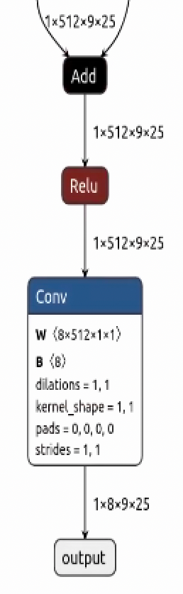

  3. ONNX export
    • Started from the pretrained culane_res18.pth from the Ultra-Fast-Lane-Detection-v2 repo
    • Used their pt2onnx.py script (modified to explicitly set opset_version=14) to export culane_res18_opset14.onnx
    • Confirmed with onnx.load that the new model’s opset is indeed version 14 (the original was opset 14 already)

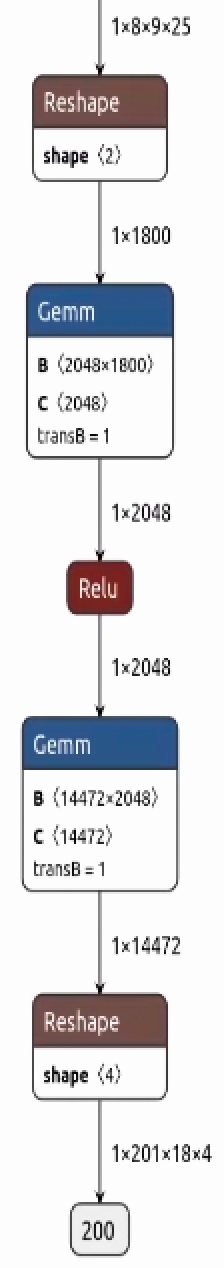

Great work so far ​@ChinmayMulgund, and thanks for the detailed response.
I wonder if this is the key issue - I feel like it’s suggesting that there’s an ONNX operation that’s not supported:
External op reshape_branching_point_to_cls_cls_dot_0_reduce_mean_dre found in the model (<class 'qtoolsv2.rewriter.operators.fqelements.Dequantize'> op). QTools may have issues quantizing this model.
As a test, maybe it’s worth trying to skip QTools to see if it allows us to test the pipeline and decoder logic?

Ah, my mistake - look like the “quantization” command isn’t recognised at al, no matter where it is. Better strip that back out. Let me ask if anyone has any ideas on this 👍
  • April 23, 2025
Okay, unfortunately it sounds like it could be because model includes a reduce_mean op, which Voyager SDK doesn’t support right now. We touched on that as being the issue earlier, but I didn’t click that it’s because that particular operation isn’t supported.

I’m still hitting the same lowering failure during the TVM “reshape” pass, with this internal check:
InternalError: Check failed: i + 2 < newshape.size() (2 vs. 2)
  • May 30, 2025
Looks like you’re making excellent progress, despite this speedbump! Nice work.
I’ve just been doing a bit of research, and saw that someone used this onnxsim tool to simplify their ONNX model, which also corrected a reshape issue they were having - might be worth investigating as the next step?
I ran the ONNX simplifier on my culane_18_inference.onnx and swapped in the culane_18_inference_simplified.onnx weight file, but I’m still seeing the same TVM reshape error :(
  • Community Manager
  • May 30, 2025
@ChinmayMulgund
Thank you for your continued efforts in working through this. Based on everything we've explored so far, it seems the most reliable path forward may involve adjusting the structure of your model slightly to align with the requirements of the compiler.
To proceed with compilation, our suggestion would be to remove the last two Reshape layers and compile the model only up to the last Conv layer — the end of your model should look like [1]. This should help resolve the compilation issue.

Thanks for the suggestion—I’ll try removing the last two Reshape nodes and compiling only up to the final Conv. I’ll report back once I’ve worked through it.
I’ve followed the suggestion to remove the last two Reshape layers and only compile up to the final Conv. I’ve attached my truncated ONNX model (culane_truncated.onnx) similar to [1]. Below is the YAML I used for deployment:
axelera-model-format: 1.0.0
description: Ultrafast lane detector (Res18 → ONNX) on CULane
pipeline:
- culane_res18-lane-onnx:
input:
type: image
# template_path: <removed completely>
preprocess:
# 1) Resize so we can bottom-crop to 288px at width 800px
- resize:
width: 800
height: 480
# 2) Center-crop to exactly 800×288
- centercrop:
width: 800
height: 288
# 3) Turn the PIL image into a [1,C,H,W] float32 tensor
- torch-totensor: {}
# 4) Normalize channels
- normalize:
mean: [0.485, 0.456, 0.406]
std: [0.229, 0.224, 0.225]
postprocess: []
models:
class: AxONNXModel
class_path: $AXELERA_FRAMEWORK/ax_models/base_onnx.py
task_category: Classification
weight_path: $AXELERA_FRAMEWORK/customers/myculane/culane_truncated.onnx
input_tensor_layout: NCHW
input_tensor_shape: [1, 3, 288, 800]
input_color_format: RGB
num_classes: 4
dataset: CULANE
extra_kwargs:
max_compiler_cores: 4
datasets:
CULANE:
class: TorchvisionDataAdapter
class_path: $AXELERA_FRAMEWORK/ax_datasets/torchvision.py
data_dir_name: CULANE
images_dir: .
masks_dir: labels/laneseg_label_w16
repr_imgs_dir_path: $AXELERA_FRAMEWORK/data/CULANE/calib
cal_data: $AXELERA_FRAMEWORK/data/CULANE/list/train_gt.txt
val_data: $AXELERA_FRAMEWORK/data/CULANE/list/val_gt.txt
However, when I run:
./deploy.py customers/myculane/culane_res18-lane-onnx.yaml
I still get the same TVM reshape error:
ERROR   :   1: tvm::relay::ReshapeRel(tvm::runtime::Array<tvm::Type, void> const&, int, tvm::Attrs const&, tvm::TypeReporter const&)
ERROR : 0: tvm::relay::InferNewShape(tvm::runtime::Array<tvm::PrimExpr, void> const&, tvm::Attrs const&, bool)
ERROR : File "/runner/_work/software-platform/software-platform/host/tvm/tvm-src/src/relay/analysis/type_solver.cc", line 643
ERROR : InternalError: Check failed: (false) is false: [12:08:22] /runner/_work/software-platform/software-platform/host/tvm/tvm-src/src/relay/op/tensor/transform.cc:679: InternalError: Check failed: i + 2 < newshape.size() (2 vs. 2) :
INFO : Compiling c-culane_res18-lane-onnx took 3.402 seconds
ERROR : Failed to deploy network
culane_truncated.onnx Model Link: https://drive.google.com/file/d/1QRtX0FlCtBlbh0ncM3Y23z3DcfsPNrXz/view?usp=sharing

Looks like you’ve done a great job of really cleaning and trimming the model! Weird that it’s still throwing the same reshape error…
Could it be that theres still a Reshape op somewhere earlier in the model? Maybe one that’s fed a shape tensor, or some kind of dynamic shape logic?
  • Community Manager
  • June 3, 2025
Hi ​@ChinmayMulgund,
Thank you once again for your continued patience and for sharing both the yaml file and the truncated model with us. I really appreciate the effort you’ve put into this.
Interestingly, with the latest YAML file you provided, everything seems to work as expected on my end (with slight changes, please see the YAML file below). This suggests that the issue might be related to something specific in your environment. It could be worth double-checking the setup or perhaps the ./deploy.py is still pointing to the model with the “Reshape layer”, please try a clean run if you haven’t already, and let me know if there’s anything we can help verify on your side!
