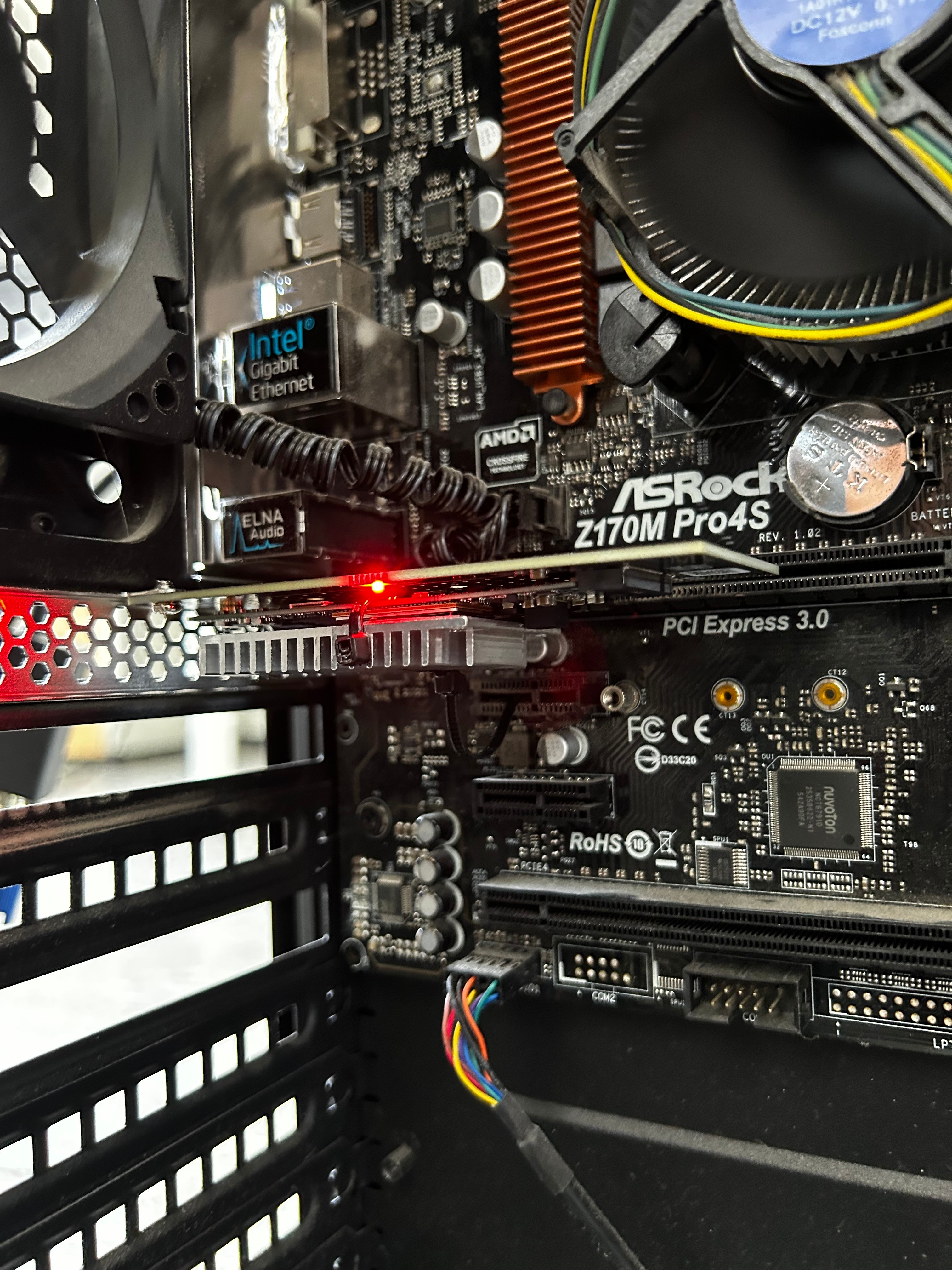

I’d be interested in seeing a photo of your new setup, if you get chance!

Thank you. Sure. Here is the setup:
  • June 18, 2025
That’s awesome, thanks ​@sifat0433! Really interesting to see that setup - it’s not something we’ve tried very much ourselves, using a PCIe adapter, so it’s great to see it working. Nice one!
