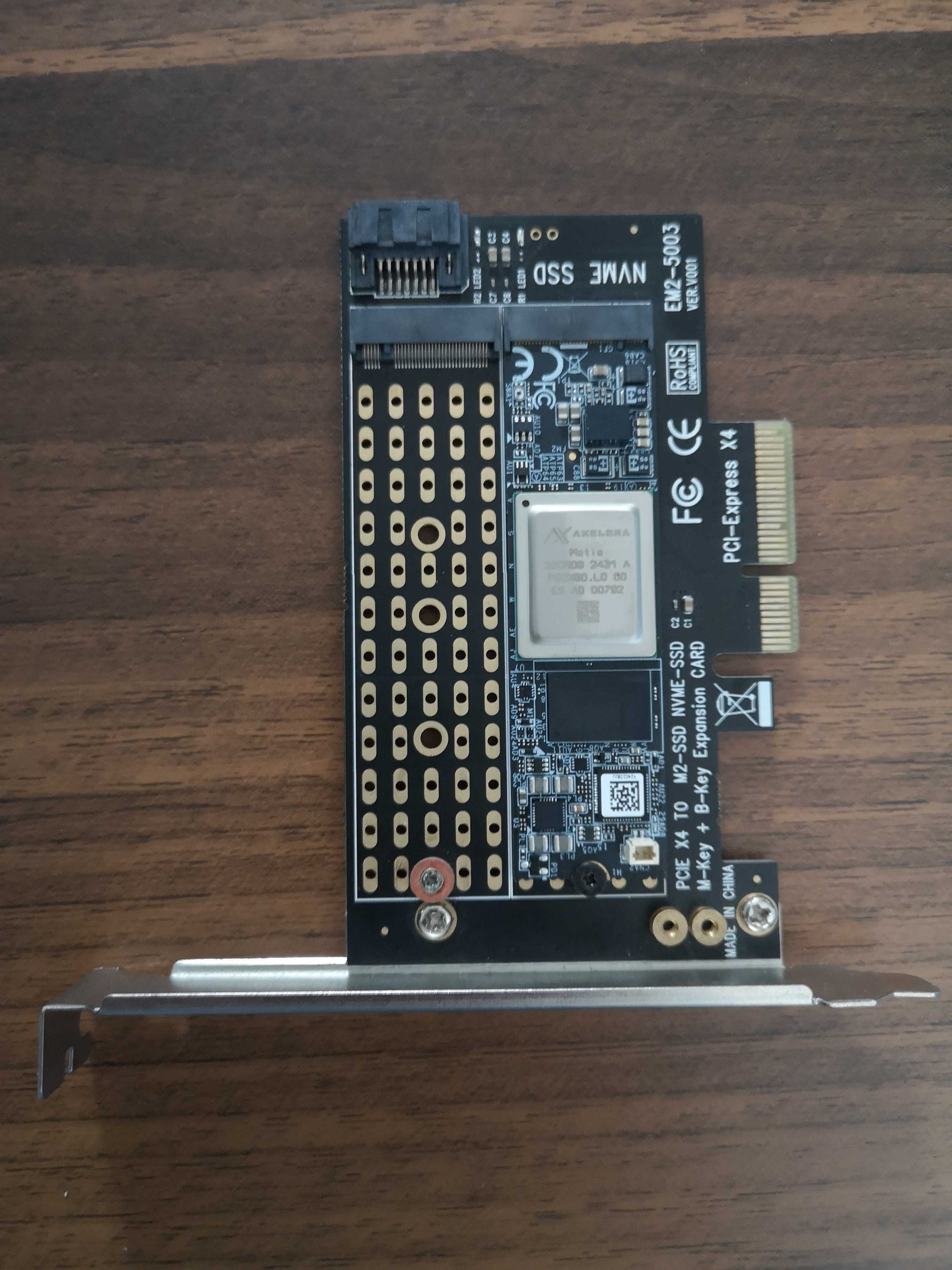

Hello! I’ve been trying to connect and use the Axelera Metis M.2 card with no success. The same M.2 on a different PC was recognized correctly by using:
lspci | grep Axelera
But now the card cannot be recognized at all on the new system. Here are some specs of the current host:
  • Dell 5820
  • CPU: Intel(R) Core(TM) i7-7820X CPU @ 3.60GHz
  • RAM: 32 GB
  • GPU: 2 Quadro RTX 5000
  • OS: Ubuntu 24.04
I’ve also tried lspci | grep 1f9d with no success. The Metis driver is already installed and loaded with modprobe.
I'd appreciate any help or insight on additional steps I could try.
Additionally, this is the adapter I’m using for the Axelera card:

As for the adapter, this is the information we have:
Dual M.2 SSD to PCI Express 3.0 X4 Adapter Expansion Card for PCIe NVMe SATA M2 NGFF SSD 2230 2242 2260 2280.
We’ll be trying out the steps suggested on your troubleshooting guide and later update you. We’ve also placed an order for other adapters in hopes to also try them in the future.

Just a quick update from our side: we’ve tested the Metis M.2 module using a different PCIe adapter—specifically, this one—but unfortunately, the system still isn’t recognizing the card.
To rule out the adapter as the root cause, we verified it using another M.2 accelerator, which was successfully detected via lspci.
We haven’t gone through the software troubleshooting steps yet, as we plan to try the Metis on a Raspberry Pi first. We’ll follow up with more details once we complete that test, but wanted to keep you posted in the meantime.
