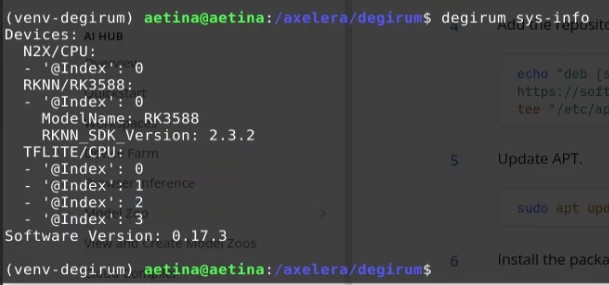

The main advantage of PySDK is that once you have the hardware setup locally, the code developed for cloud inference can run locally by changing @cloud to @local. This allows people to start/continue development without having to battle hardware setup issues. Once you install PySDK (pip install degirum), please type
degirum sys-info
 If you see Axelera Metis listed as one of the devices, you are good to go. FYI, we are using Axelera runtime 1.3.1. If this is installed on your system, PySDK will pick it up. Please let us know if you encounter any issues.

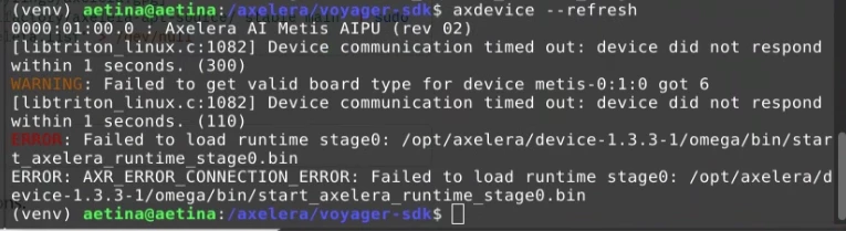

Hi ​@shashi.chilappagari , I ran into some issues. I have followed the installation instructions for linux, and also followed the driver installation instructions for Axelera here since degirum sys-info did not show Axelera device on the machine. I noticed that one package had to be downgraded (metis-dkms 1.0.2 - was using 1.0.3 before). Note that I had previously installed the latest Voyager SDK to my machine.
Anyway, after going through the process in the driver installation page without any errors and hard-power-cycling the board, I still don’t see the Metis device.
Moreover, now even the Axelera sdk has issues refreshing the device as below:
I have a feeling this may be due to the older version of runtime used by the Degirum (that we installed during driver installation?)

Thanks for sharing this. I will loop in our SW engineer who can help with this issue. One nice thing I see from your logs is that the Rockchip runtime RKNN is picked up by PySDK. This will allow you to use same codebase to run some models on the built-in NPU of the RK3588 (which has 6TOPS and can run detection models at >60FPS).
Btw, if i switch back to metis-dkms=1.0.3, I can use the hardware with voyager-sdk again, but still does not appear in degirum sys-info . For your info, my M.2 card is running the latest firmware, from the latet voyager-sdk release:
Yes, you are right, and I noticed that too earlier. In fact, i believe they are appearing because I had previously installed the Rockchip drivers too as per your driver installation guide :) It’s something I will try as well. That said, I do need to get the models running on the Axelera hardware anyway, so help in that regard will be appreciated. Ideally, if degirum works with the latest Axelera runtime, that will be ideal so I don’t need to switch between things continuously 😉 Thanks.

We will definitely focus on getting it to work locally for you. In the initial stages, it is quite common to have versions not in sync, but we are working with Axelera to make sure PySDK releases stay in sync with Axelera updates. Good thing is that we have the same system as you, so we might bother you with same questions regarding the exact setup you have. Once we get it work internally with the version you have, we will make a new release. Our hope is that we get things to work soon so that you don’t have to switch. Meanwhile, please feel free to browse pysdkexamples as the code for cloud and local is same except for 1 line.

Regarding Axelera: we replicated your issue and confirmed that it is due to PySDK supporting runtime 1.3.1 and your system having runtime 1.3.3. Internally, we were able to build a new PySDK that supports 1.3.3 and it passed all tests. An official release of PySDK with support for 1.3.3 will be made mid next week. I will keep you posted.
