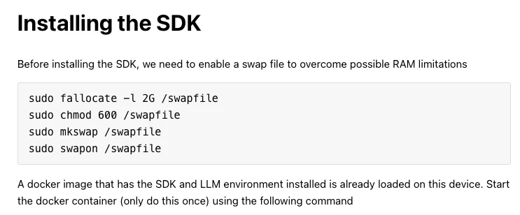

In terms of the error here, I wonder if it’s this bit about the swap file in the guide?
Do you know if that worked? Because this kinda looks like a RAM issue, I think...

Thanks for your suggestion, indeed it might be issue with swap file. It was created properly, however in the meantime I had to reboot the board and the swapfile was deactivated. I just started make again, lets see what will happen.

Maybe it is worth to add in the instruction step to make the swapfile permanent, so it does not deactivate after reboot.

After making sure that the swap file is activated I was able to make the operators successfully.

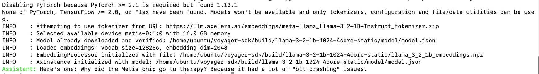

And I was able to run inference with one model from the zoo!
When running the command:
./inference_llm.py llama-3-2-1b-1024-4core-static --prompt "Give me a joke"
The output is:
Just to confirm, the following line:
INFO    : Selected available device metis-0:1:0 with 16.0 GB memory
means that the model is running on AIPU not CPU?
  • March 2, 2026
Excellent work, ​@Dominik !
Yeah, the metis-0:1:0 naming is the giveaway that it’s on the AIPU. The metis-X:Y:Z format is the device identifier for the Metis AIPU hardware itself. If it had fallen back to CPU, you'd see a CPU device selected instead, not a metis-X:Y:Z device. The fact it also reports 16GB of memory is consistent with the Metis hardware's onboard memory, not host CPU RAM. 👍
