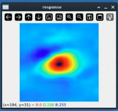

    • Zero-mean + L2-normalized valid cross-correlation (per-channel sum), upsampled 16× with Hann window.
       Normalized cross-correlation response
      Damped position/scale updates; interactive re-select (r), quit (Esc).
  • Validated with fixed-ROI diagnostic runs. Achieved ~390 FPS backbone / ~50–80 FPS full tracker on Metis M.2.
