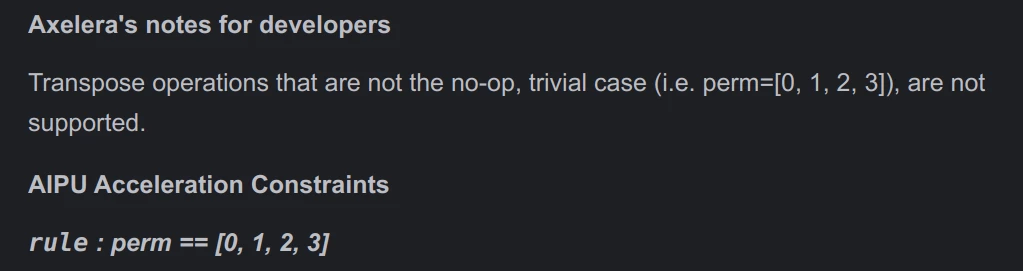

In your documentation it is written:
So if my reading is correct you’re indeed not supporting Transpose other than no-transpose?
  • September 12, 2025
Hi ​@npi!
Yeah, as far as I know, any other permutation is unsupported at the moment, so it needs to be [0, 1, 2, 3]. Hence the mismatch error.
