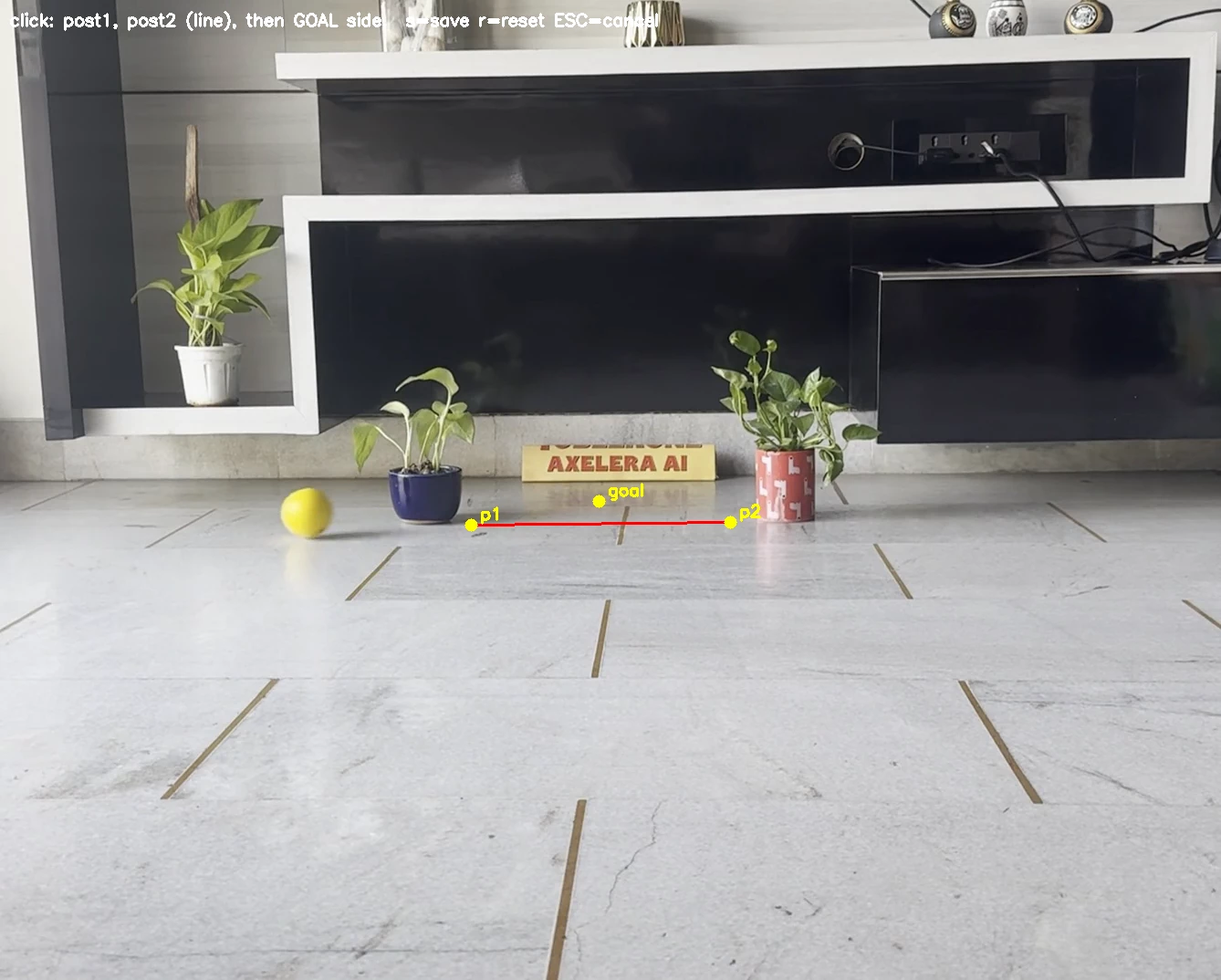

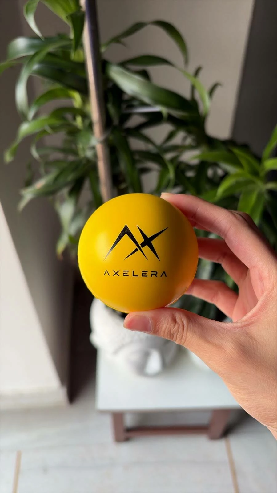

The official match ball is the Axelera stress ball. The goalposts are… two plants in mugs. I roll the ball at the goal, and the system calls GOAL or MISS — and crucially, rebounds off the wall behind don't count, because the ball has to actually cross the line. I don't detect the goal itself; I just eyeball one frame and click where the posts are to draw the line:
Interactive goal posts and goal line setup

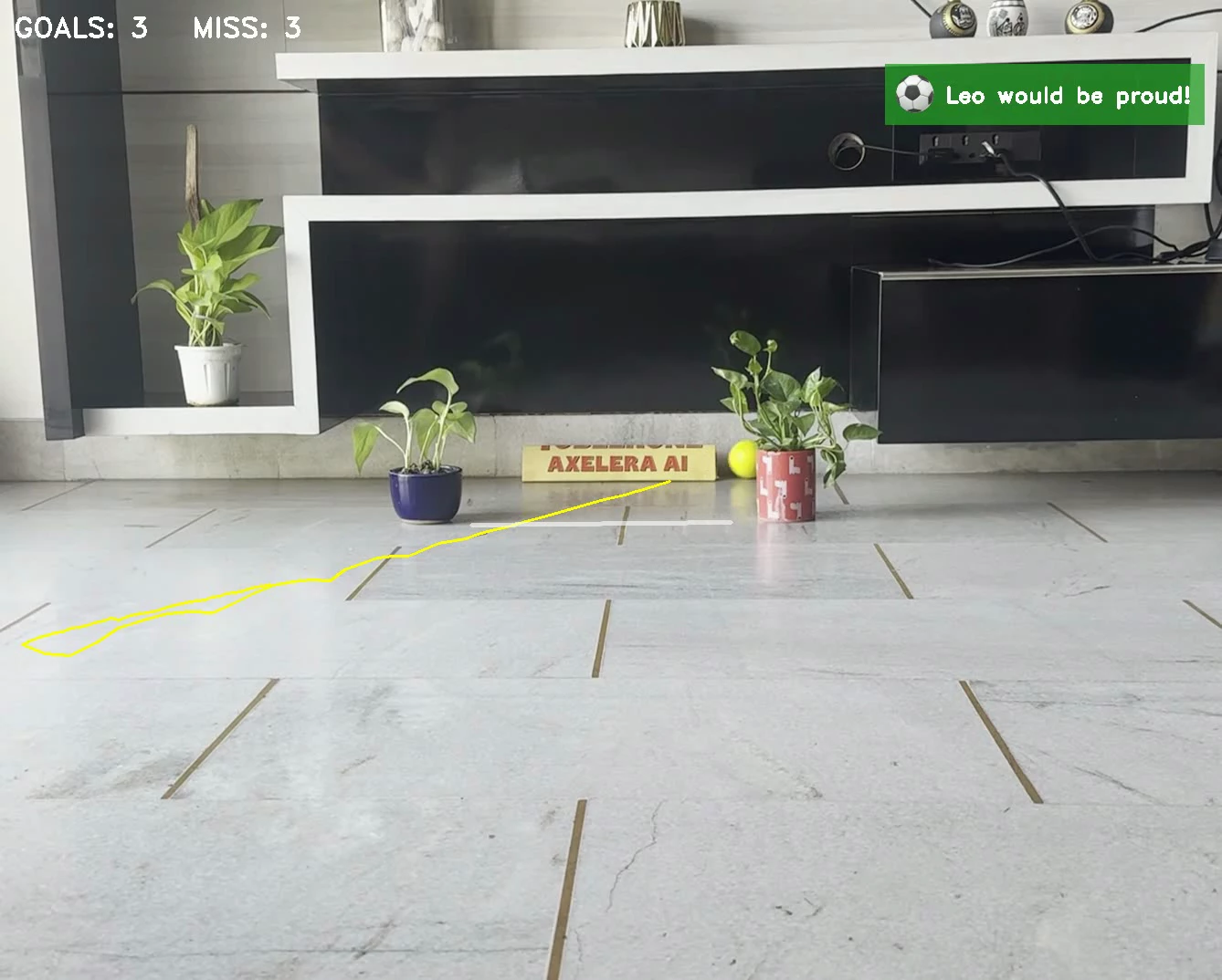

VAR confirms; What a strike indeed!

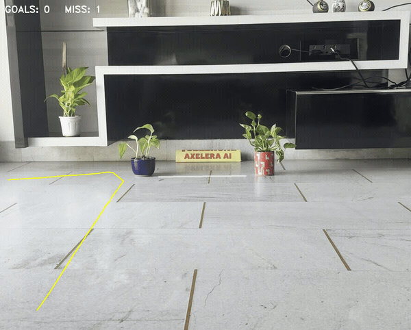

...and one that drifts just wide
