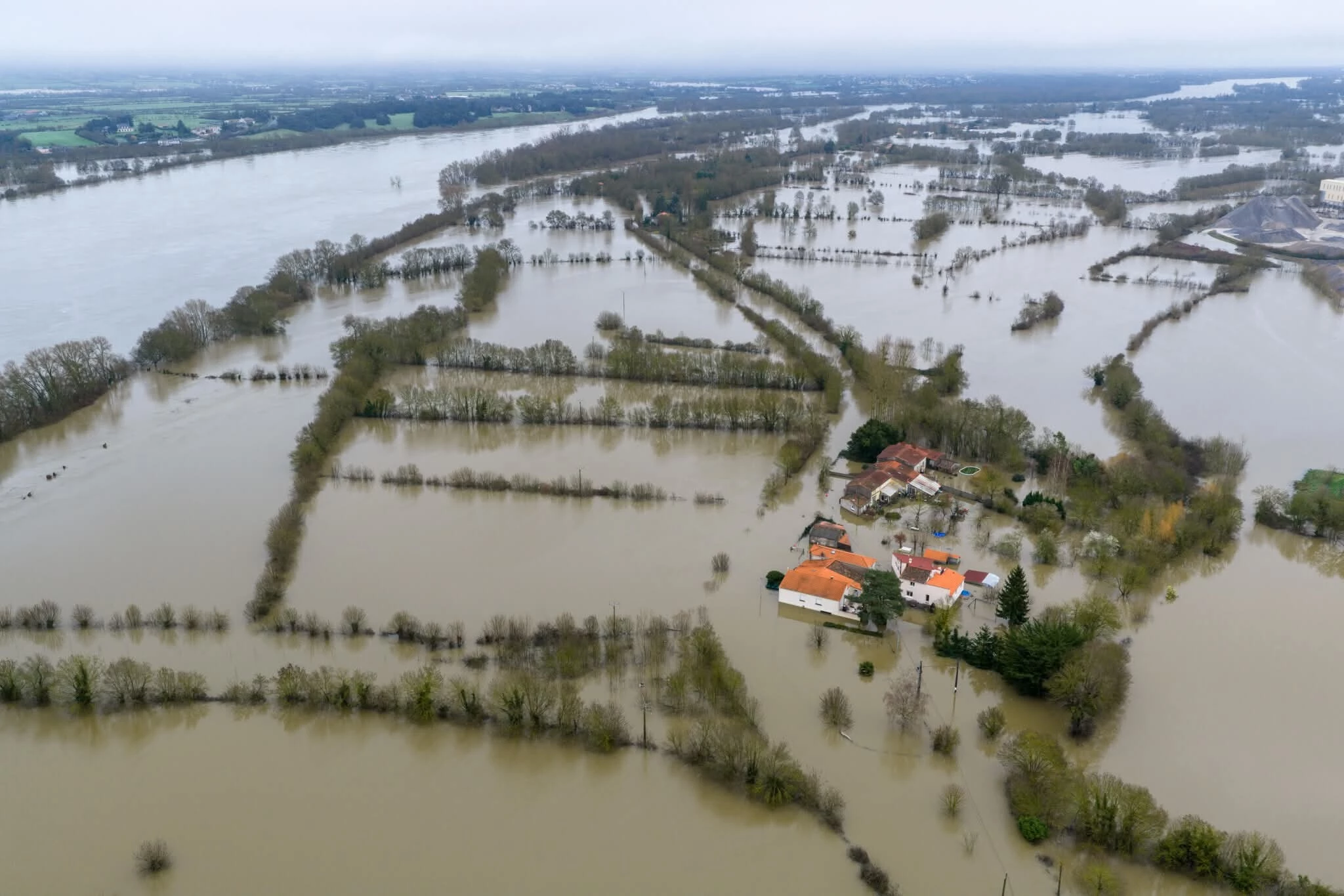

Fields along the Maine River, January 2026

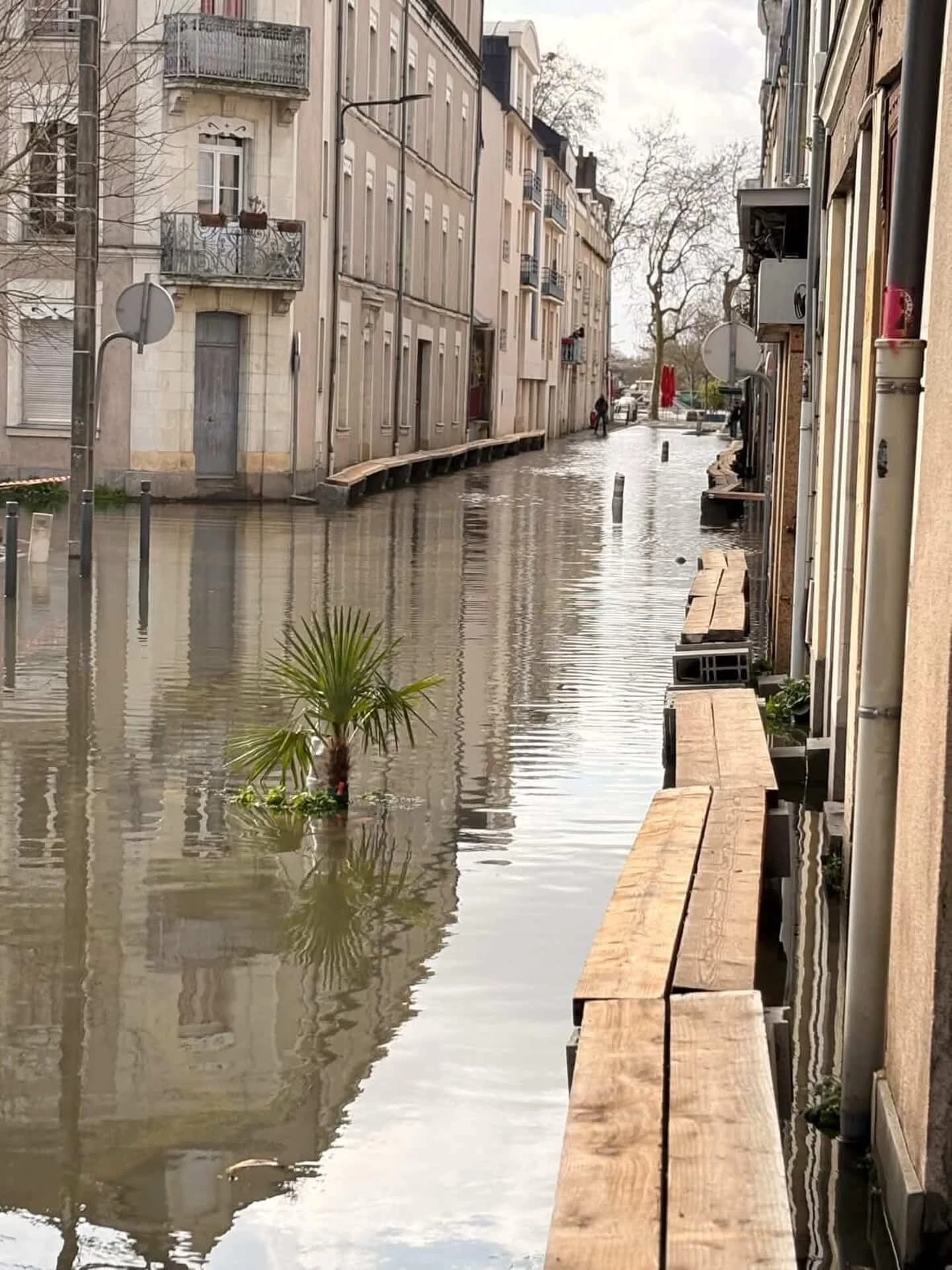

Streets of Angers during the flooding
Flooding near my home this winter, the kind of rapidly changing situation AeroFlood is designed for.

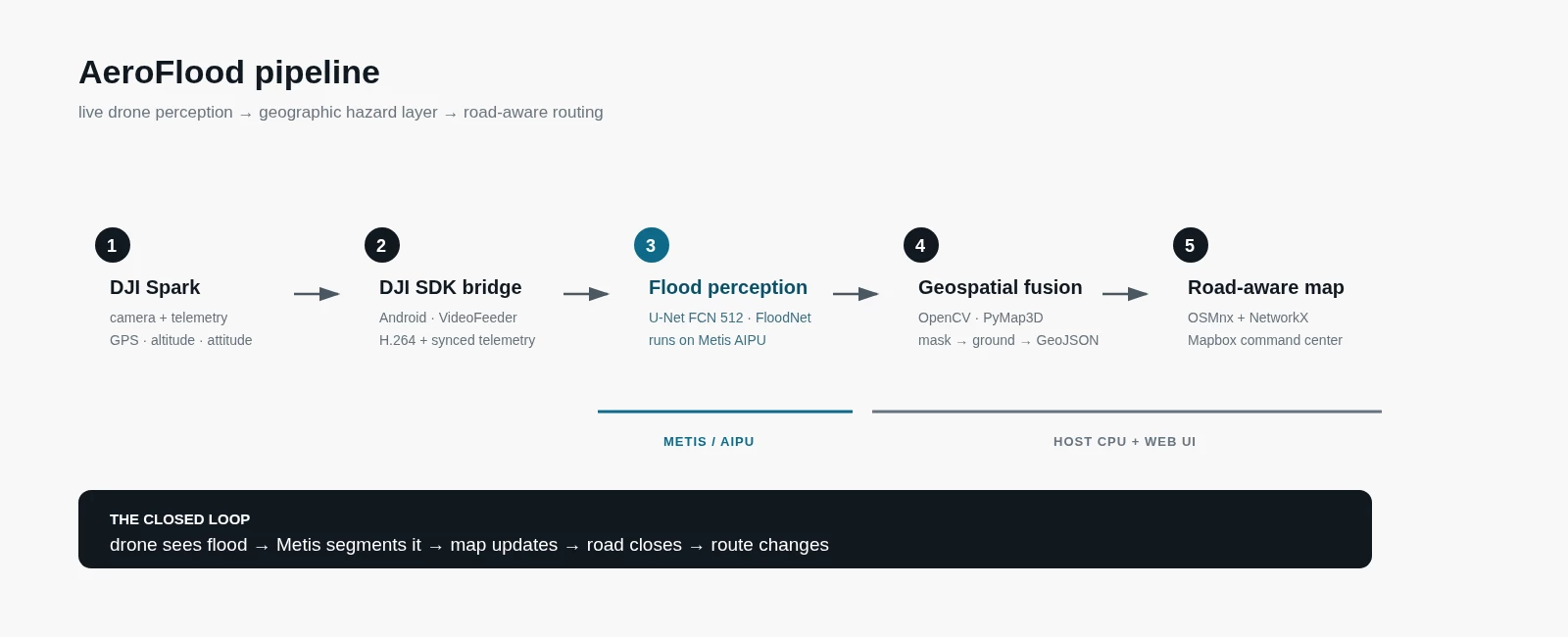

AeroFlood turns a live drone flight into a continuously updated map of flooded areas, affected infrastructure and usable roads. A DJI Spark surveys the area while a portable ground station built around the Dell XE5 and its 16GB Axelera Metis PCIe card processes the video locally.
Flooded roads, flooded buildings and water surfaces are segmented, projected into geographic coordinates from drone telemetry and accumulated as the drone moves. Intersecting this hazard layer with the road network lets us invalidate flooded road edges and recompute an alternative route.
The final demo should tell the whole story in one sequence:
drone observes flood  =>  Metis segments it  =>  map updates  =>  road becomes unavailable  =>  route changes
For field testing, we can safely fly over ponds and lakes to exercise live acquisition, segmentation and georeferencing; recorded flood imagery and FloodNet will validate flooded-road scenarios.

Our DJI Spark is supported by DJI Mobile SDK v4. The target acquisition chain is:
DJI Spark  =>  Android bridge  =>  H.264 video + synchronized telemetry  =>  Dell XE5
The phone exposes video, GPS, altitude, aircraft attitude and gimbal state; the AI pipeline remains on the ground station.

The division of work is intentional:
Metis: semantic segmentation
CPU: telemetry synchronization, georeferencing, temporal fusion, road intersection and routing
Frontend: React + Mapbox GL JS
