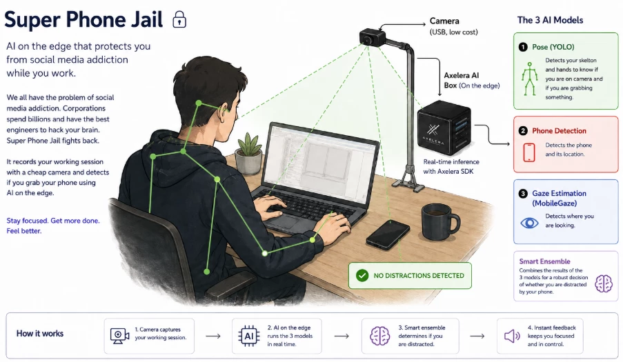

Super Phone Jail is a program that protects you from the social media addiction, specifically from picking up your phone while you work on the computer.
We all have the problem of social media adiction and it can make us feel really bad when we are on the computer and we randomly pick up the phone and waste half an hour without noticing.
Think about it, the corporations that run social media have unlimited money and the best engineers to hack your brain, and so they do… Until now, because Super Phone Jail keeps you away from your phone by recording your working session with a cheap camera and detecting if you grab your phone using AI on the edge. The algorithm comprises 3 ML models. The first one detects your skeleton using a YOLO so that we can know if you are on camera and if you are grabbing something. The second one detects the phone. The third model detects the gaze (where you are looking). By smartly ensembling the results of the three models we obtain a very clear result of if you are distracted or not by your phone. If the user is distracted by the phone, an LED flashes
Challenges: while there is support in the Axelera SDK for standard object detection as well as pose estimation, there isn’t to my knowledge support for gaze estimation. That is fine, because I believe that with the help of Axeleras agent and one month of time I could potentially add support for this new task! The current plan is to use MobileGaze which uses operations fully supported by Axelera’s chip.
I'll build the whole pipeline with Voyager Wingman: it generates and wires the three models, helps me compile MobileGaze onto the Metis card, and lets me iterate live on the hardware until it works. Here is the prompt:

ILLUSTRATION:
This is the hardware sequel to Phone Jail (https://github.com/ehxuban11/vercel-hackathon), which won 2nd place at the Vercel London hackathon.
