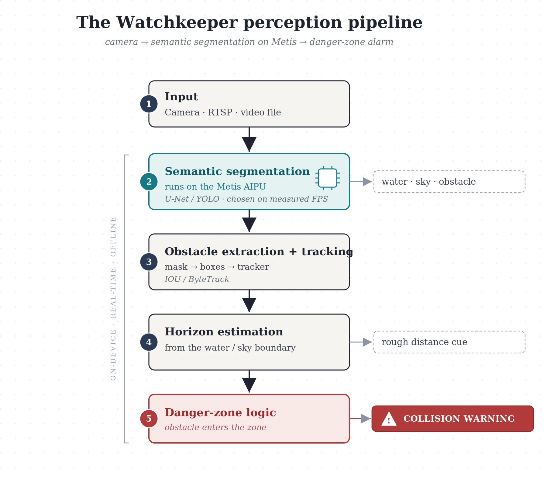

The base model is U-Net FCN, the semantic-segmentation network from the Voyager Model Zoo, fine-tuned on MaSTr1325, a maritime dataset labeled per-pixel for exactly these three classes. Semantic segmentation is the right paradigm here (every pixel is water, sky or obstacle), and the water/sky boundary gives a clean horizon line as a rough distance cue, so a ship on the horizon reads differently from a buoy 10m off the bow. The perception front-end is deliberately swappable: the danger-zone logic consumes either a segmentation mask or detection boxes, so if measured FPS or robustness on Metis favours a detector, we drop in a fine-tuned YOLO (YOLOv8 / YOLO11) instead of U-Net. We pick the model empirically on the hardware. Segmentation runs on the AIPU; tracking and the danger-zone state machine stay on CPU

A boat at sea has no reliable connectivity meaning cloud inference is off the table. Collision avoidance is latency-critical and must run fully offline inside a small vessel's power budget. Metis runs the segmentation model in real time on the AIPU while the CPU handles tracking and alerting. The zoo's U-Net FCN already benchmarks comfortably above real-time on the Metis PCIe card, so there's headroom for the post-processing.

Build me a real-time maritime obstacle-detection pipeline for an
autonomous boat, running on the Metis PCIe card.
GOAL
Segment every video frame into three classes: water, sky, obstacle: then
warn when an obstacle is close to the boat.
MODEL
Use the U-Net FCN semantic-segmentation model from the Voyager Model Zoo as
the base, at 512x512. I will fine-tune it on the MaSTr1325 maritime dataset,
which is labeled for exactly these three classes: help me load my fine-tuned
weights through the custom-weights path, then compile and quantize the model
for the Metis AIPU. Report the mIoU after quantization and any unsupported
operations or host fallbacks.
INPUT
Start from a video file, then switch to a USB webcam and to an RTSP stream
using the same pipeline. Handle the input color format the model expects.
PIPELINE
Run the segmentation on Metis. In Python post-processing: take the obstacle
mask, extract connected components as bounding boxes, track them across
frames, estimate the horizon from the water/sky boundary as a rough distance
cue, and define a "danger zone" in the lower part of the frame. When a tracked
obstacle enters the danger zone, draw it in red and trigger an on-screen
COLLISION WARNING.

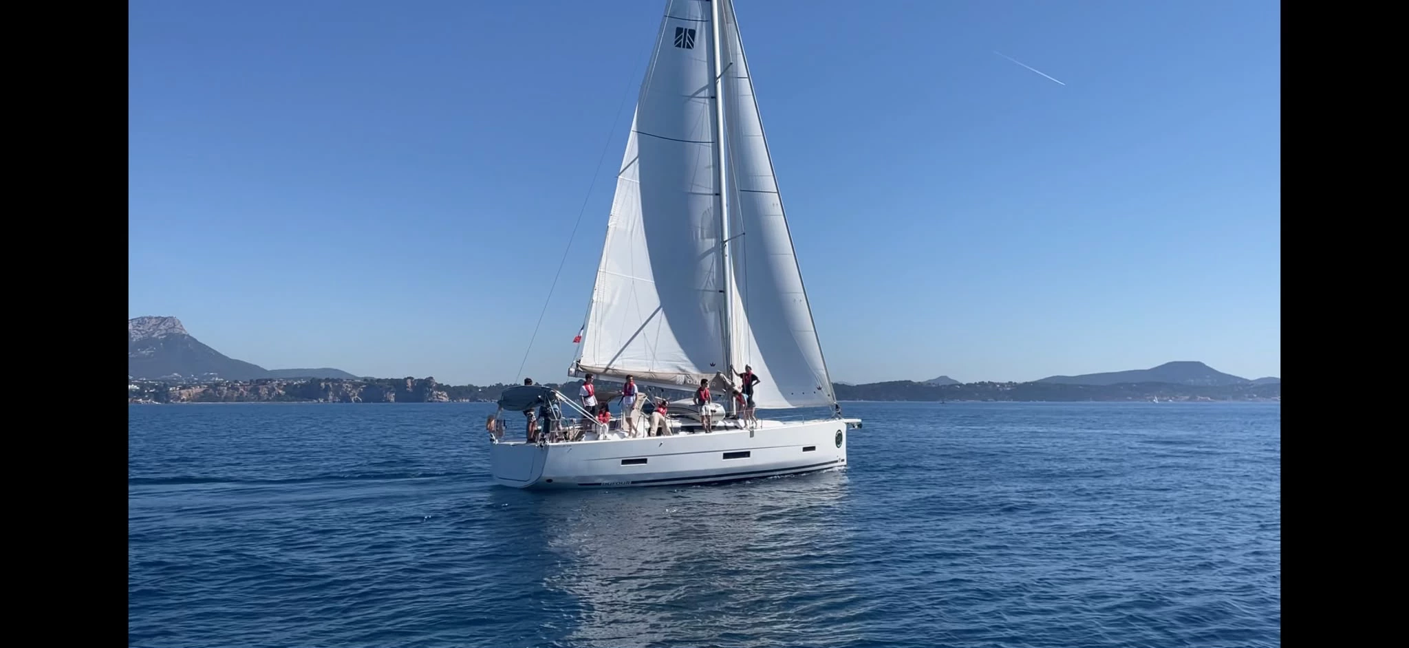

As an example, here is a photo taken during a cruise, where another sailboat crossed our path about forty meters away:
